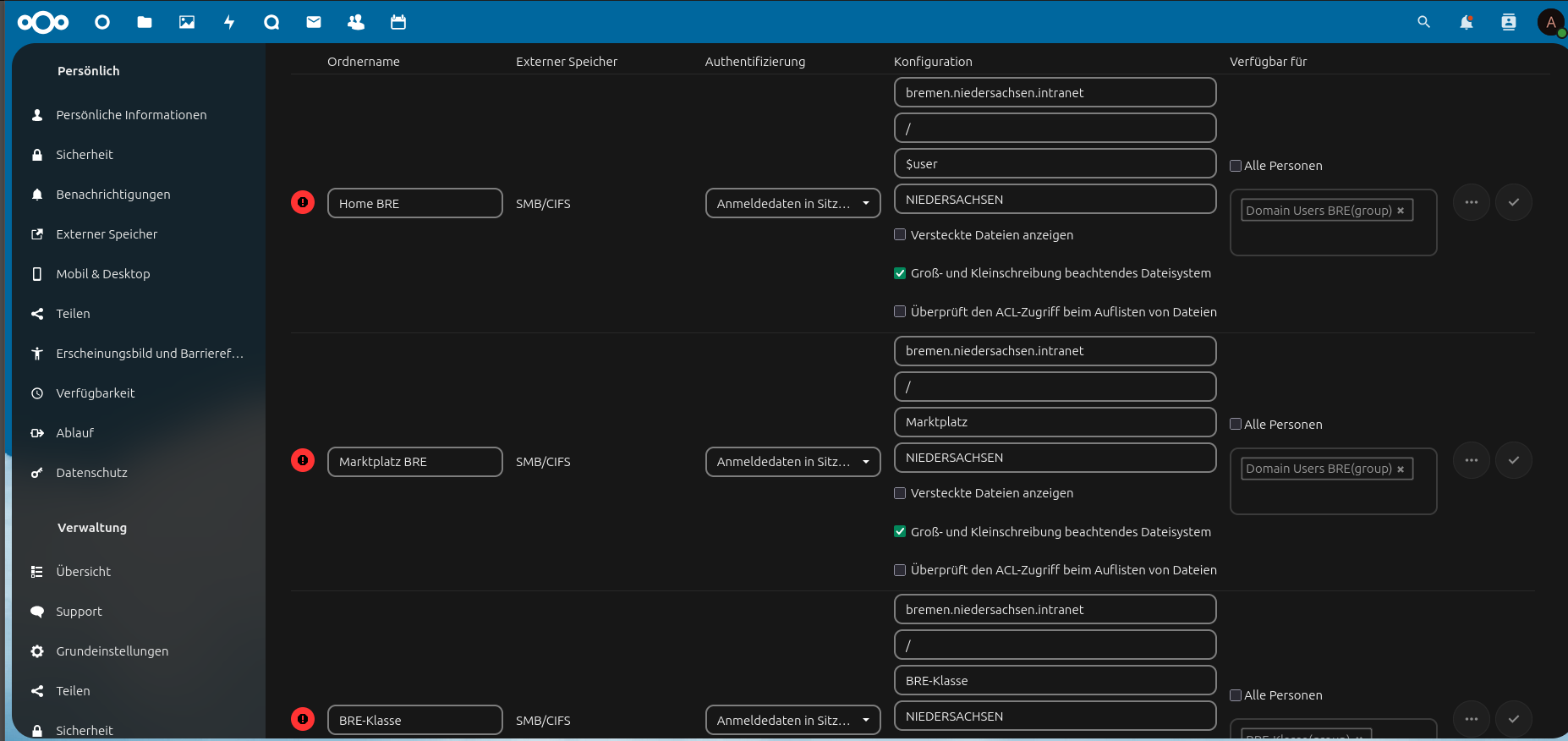

Manual Configuration
A mount can be configured very easily with a generic mount, logged in as the Nextcloud Administrator. Configure the mount as follows and save it by clicking on the small tick icon.
Folder name: Home
External Storage: SMB/CIFS
Authentication: Log-in credentials, save in session
Configuration Host: hostname or ip
Configuration Share: /
Configuration Remote Subfolder: $user (for home share) or share name
Configuration Domain: windows domain
Available for: empty

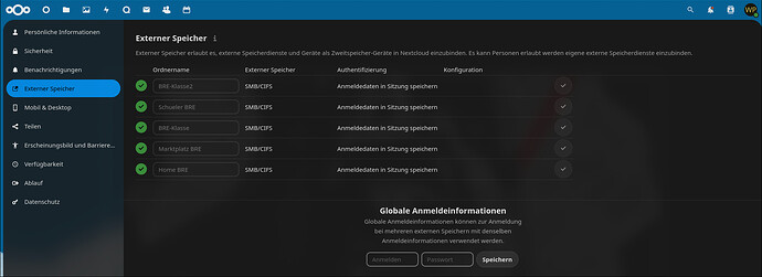

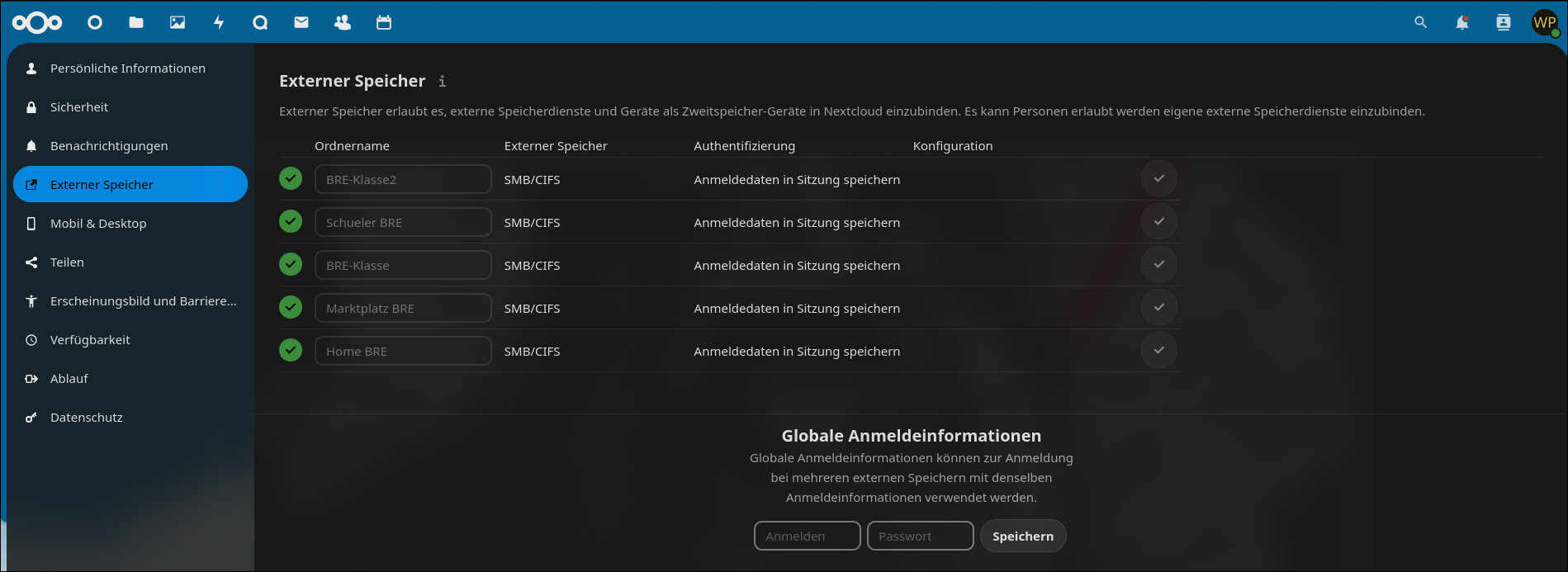

Note: A red indicator may appear while entering settings as seen in the screenshot. This is normal and will turn green in the corresponding users settings once all required fields are completed and saved.
