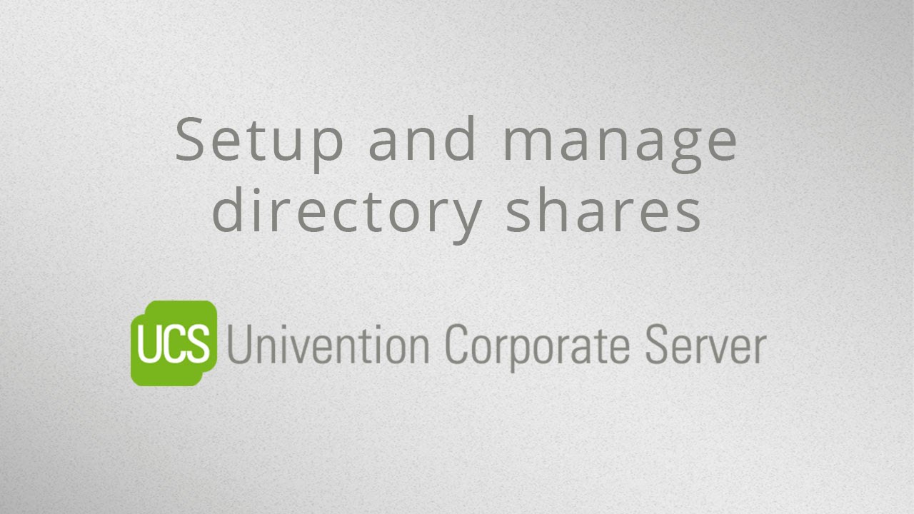

I tried this video till minute 2 on a windows 10 machine
and than i tried to use the file explorer and “add network share” with
\IP\shares\feedback
and the username pw of a user within the domain user group.
I also tried the ucs-4242.domain.intranet one with no success either.
