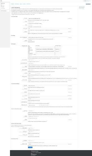

After the plugin is enabled open the plugin-settings.
LDAP enrollments settings:
Nested groups allow you to assign groups to classes and workgroups instead having to add the individual users.
