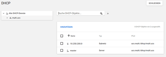

That’s the point.
The daemon is running fine but is not properly configured.
On the Web-GUI (UMC) make sure:
  • Open the DHCP module (blue)
  • On the left patz select the service (should be one)
  • Check then on the right if you have configured a subnet where the dhcp server resides
  • Check if you have added a DHCP-server named as your server
Should look like this:
Once properly configured it should run smoothly.
/KNEBB

No way. You do not want to offer the IP address of your dhcp-Server. Just change the range here to a range which you do want to assign to clients. Use 10.0.0.10 as first address and make sure no statically/ manually assigned IP is in this range.
Is does not find it’s own entry currently. This is the only item which is not actually related to “do it right and it will work” :wink:
Here I would suggest trying to remove the server from the service and re-add it again. IF it works, all is good.

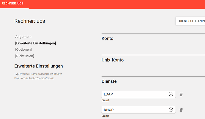

If not, check if the server has the “DHCP”-Service flag set:
