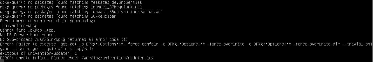

Update from 5.0-10 to 5.2 fails with errors from univention-dhcp
Trying to upgrade UCS 5.0-10 to 5.2 (and 5.2-1) but all I’m getting is failed update.
I tried twice now and on both occasions get exact same error.
@MiracErde Any suggestions how to resolve this?

Hier dasselbe :frowning:
Abbruch beim Upgrade —> 5.2
Fehler traten auf beim Bearbeiten von:
univention-dhcp
E: Sub-process /usr/bin/dpkg returned an error code (1)
Error: Failed to execute “apt-get -o DPkg::Options::=–force-confold -o DPkg::Options::=–force-overwrite -o DPkg::Options::=–force-overwrite-dir --trivial-only=no --assume-yes --quiet=1 -u dist-upgrade”
exitcode of univention-updater: 1
ERROR: update failed. Please check /var/log/univention/updater.log

FAIL
Checking role_package_removed … OK
Checking slapd_on_member … OK
Checking ssh … OK
Checking system_date_too_old … OK
Checking term … OK
Checking valid_machine_credentials … OK
The system can not be updated to UCS 5.0 due to the following reasons:
package_status:
The package state on this system is inconsistent.
Please run ‘dpkg --configure -a’ manually
Error: Update aborted by pre-update script of release 5.0-10*
So my error was linked to what seemed PostgresDB and the Univention DHCP package.
I found removing the package just before allowed me to upgrade. After the successful update, I installed the package again and all was fine (the configuration was retained).
