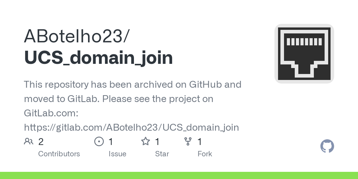

git clone https://github.com/ABotelho23/UCS_domain_join
cd UCS_domain_join
sudo bash setup.sh

The script for the AD join comes from here:
many thanks to the developers!

Thanks for the credit!
If you wanna work together I’d gladly take pull requests for the script!
I did in fact notice that the sudoers file modification is incomplete. It allows a user to perform sudo actions, but isn’t perfect because the user isn’t also added to the sudo group. I’ll be tweaking that soon.
If there is an extra rule for the user he hasn’t to be added to the sudo group. But if the user should have full admin rights I would prefer to add him to the sudo group. Or to create a rule for a domain group.
That’s right, I’ll probably simplify it and simply add the user to sudo group without adding to sudoers file.
As for a domain group, the idea here is to say give a single user who may ā€œownā€ the device admin permissions to that device only. I can’t think of a simpler way for a device-by-device way of doing it. I’d gladly modify it if you have a clean way of doing it on the domain’s end.
