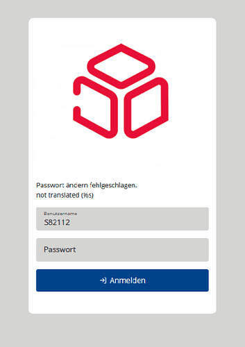

Problem: SSO - Password change failed - not translated (%s)
If an attempt is made to perform a password change via SSO in this case SimpleSamlPHP, the following error occurs.
For example, if a teacher resets the student password and the student then wants to change their password, the following error occurs.
