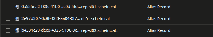

If there is no other server to copy from, you can create an alias entry via UMC for the faulty entry, as a workaround. In DNS Module, there are already these entries, use the faulty one to create an alias, to an existing replication partner.
