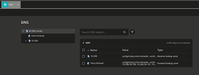

2. Solution
Check the domain’s DNS settings. If the resolution is not working properly, the systems cannot be found or resolved correctly. This leads to Samba replication errors.
In UCS, this can be done using the DNS module.
Administration of DNS data with BIND
