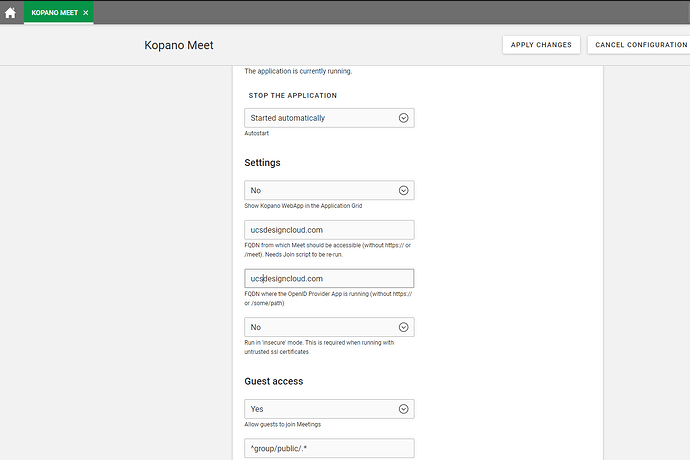

Sorry - here you go:
root@ucs-bdc:~# ucr dump | grep kopano/docker | grep -v PASSWORD
kopano/docker/FQDN_MEET: ucsdesigncloud.com
kopano/docker/FQDN_SSO: ucsdesigncloud.com
kopano/docker/GRID_WEBAPP: no
kopano/docker/INSECURE: no
kopano/docker/MEET_GUEST_ALLOW: yes
kopano/docker/MEET_GUEST_REGEXP: ^group/public/.*
kopano/docker/TURN_SERVICE_URL: https://ucs-turn.kopano.com/turnserverauth/

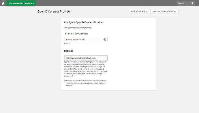

From appearances, it seems like the sign in window from kopano meet is failing to connect with the openID login window in the right place, like they are missing each other
Here is openid-connect-provider
ProxyPass /.well-known/openid-configuration http://localhost:8777/.well-known/openid-configuration retry=0
ProxyPass /konnect/v1/jwks.json http://localhost:8777/konnect/v1/jwks.json retry=0
ProxyPassReverse /konnect/v1/jwks.json http://localhost:8777/konnect/v1/jwks.json

in each place there is only ‘bell’ replaced by ucs - thanks for looking and just let me know what else is helpful for you!
Ah, so the www. in the openid config windows wasn’t just sloppy anonymisation, but part of the actual configuration.
The value in FQDN_SSO needs to match oidc/konnectd/issuer_identifier (minus the https).
Ok - that makes sense - so I changed it in the UCR:
kopano/docker/FQDN_MEET: www.belldesigncloud.com
kopano/docker/FQDN_SSO: www.belldesigncloud.com
Still getting the same error, should I change it anywhere else? Thanks!

Unfortunately I am running out of idea. Your openid provider responds with temporarily_unavailable and therefore login fails. At least initially the openid discovery document did not properly respond on your system (but later it was).
I recommend reaching out to the Kopano support so that someone can have a direct look at your system.

I can connect to https://meet.domain.com/meet, I am redirected to the login page on id.domain.com and after entering the credentials I end up with “ERROR 400”.
What Iam missing ?
(Checking the insecure checkbox in order to exlcude certificate problems does not change anything)
The second point I am confused about are the docker containers I have running now:
“docker ps” shows me:
8c6cba0612e5 docker.software-univention.de/kopano-meet-kopano_konnect:2.1.0_0-1 "wrapper.sh" About an hour ago Up About an hour (healthy) 6777/tcp, 8777/tcp kopano_konnect
fc11a75f3d29 docker.software-univention.de/kopano-meet-kopano_meet:2.1.0_0-1 "/kopano/start-servi…" About an hour ago Up About an hour (healthy) kopano_meet
1d607da232f9 docker.software-univention.de/kopano-meet-kopano_kapi:2.1.0_0-1 "/usr/bin/dumb-init …" About an hour ago Up About an hour (healthy) kopano_kapi
77efaaaa4048 docker.software-univention.de/kopano-meet-kopano_kwmserver:2.1.0_0-1 "docker-entrypoint.s…" About an hour ago Up About an hour (healthy) 6778/tcp, 8778/tcp kopano_kwmserver
8f9ad02043d1 docker.software-univention.de/kopano-meet-web:2.1.0_0-1 "docker-entrypoint.s…" About an hour ago Up About an hour (healthy) 80/tcp, 443/tcp, 0.0.0.0:2015->2015/tcp kopano_web
1eff67b227c6 docker.software-univention.de/kopano-meet-kopano_grapi:2.1.0_0-1 "/usr/bin/dumb-init …" 20 hours ago Up 3 hours (healthy) kopano_grapi
a81cfef1fb03 docker.software-univention.de/openid-connect-provider:1.1-konnect-0.23.3 "docker-entrypoint-u…" 4 months ago Up 3 hours (healthy) 0.0.0.0:8777->8777/tcp zen_ardinghelli
Why do I have now to “konnect” containers running ? As I described I had a running setup of OpenID Connect before installing Kopano Meet. So why has there been anyway installed a (supposingly) default containter ?
Thanks for any assistance.
