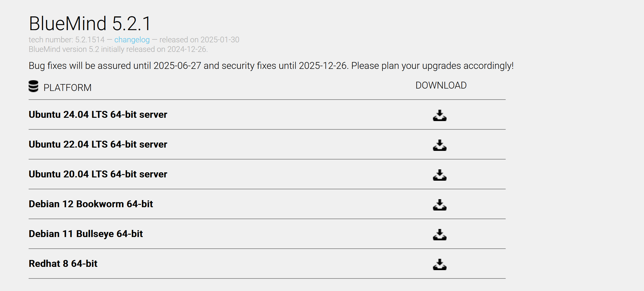

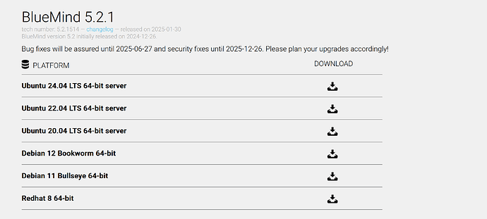

you may also have a look on BlueMind, der 1. europäische Groupware-Anbieter für Unternehmen - in the community edition there is no user limit - but only Mobile Phone Active Sync and Webmail - without subscription no Outlook MAPI access
https://download.bluemind.net/kc/
