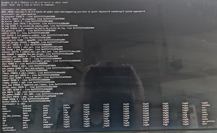

I try the suggested checks (Common problems):
(initramfs) cat /proc/cmdline
BOOT-IMAGE=/vmlinuz-5.10.0-0.deb10.30-amd64 root=/dev/mapper/vg_ucs-root ro quiet loglevel=0 rootdelay=5 splash apparmor=0
The rest is too much to tap it and there is no way to copy&paste so I attach a photo:
I’m really running out of ideas now and would be thankful for any hint!
