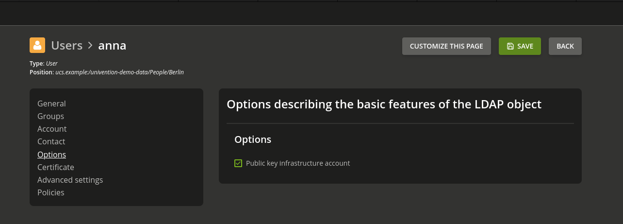

To create a user certificate, open the [Options] tab in the user’s LDAP object and select “Public key infrastructure account” . This step isn’t needed for Simple authentication accounts.

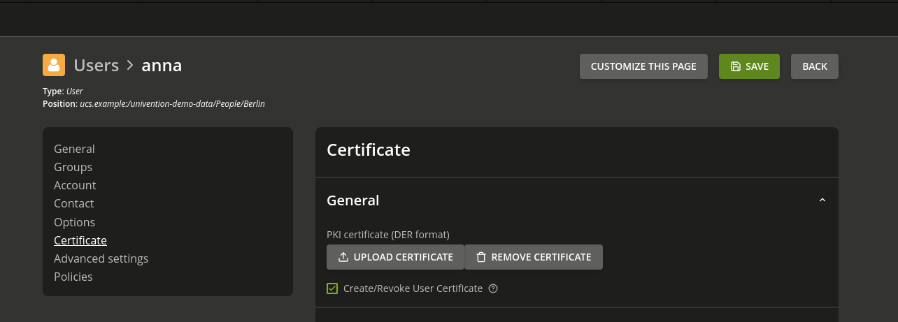

Now switch to the User Certificate tab and select “Create/Revoke User Certificate” .
When saving, the certificate is created and saved in the directory provided in /etc/univention/ssl/user/ in a subdirectory with the user’s UID. By default, only the user itself and the group entered in ssl/usercert/admingroup have read permission on the files. It is recommended to create a file share of the folder containing the certificates, so users can access them remotely. This can be easily achieved by following the UCS documentation Management of shares in UMC.
Note: Optionally, the standard valid time of the certificate can be overwritten here. If the field is left blank, the standard valid time from the UCR variable ssl/usercert/days will be used.
When a certificate is to be revoked, it is sufficient to untick “Create/Revoke User Certificate”. The certificate files are removed from the LDAP, but not deleted from the filesystem. If the UCS root CA was used to sign the user’s certificate, an entry is made into the Certificate Revocation List specified by /etc/univention/ssl/ucsCA/crl/ .
When a certificate needs to be renewed, it is sufficient to tick “Renew User Certificate” and save the changes made. The old certificate will then be revoked and a new one will be created with the settings from the former certificate.

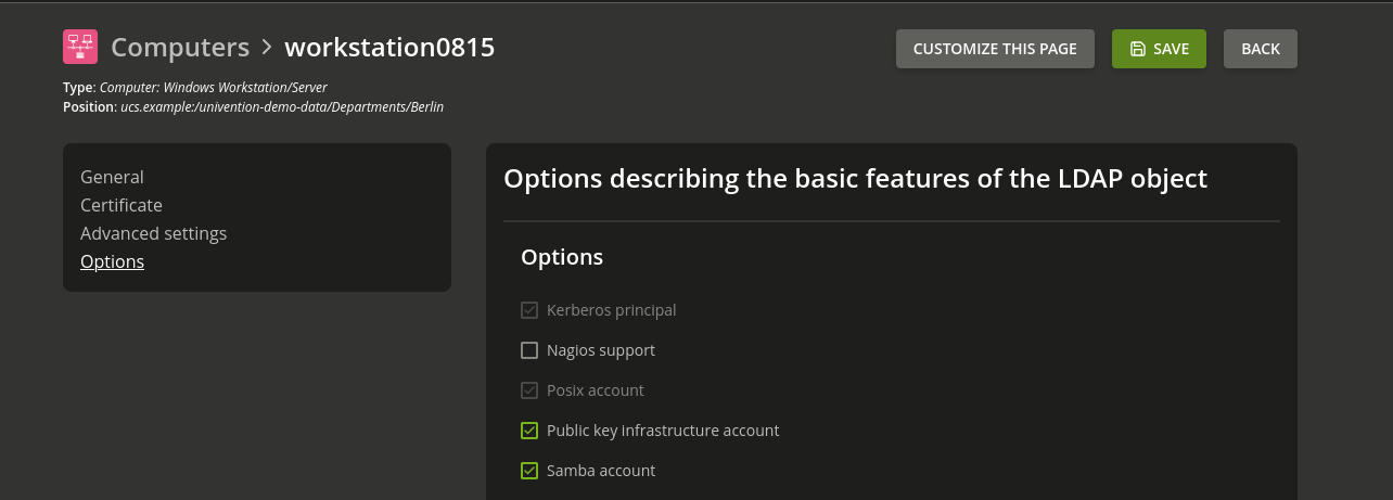

To create a computer certificate, open the “Options” tab on the computer’s LDAP option and select “Public key infrastructure account”. Then press save, and move into the clients options once again.

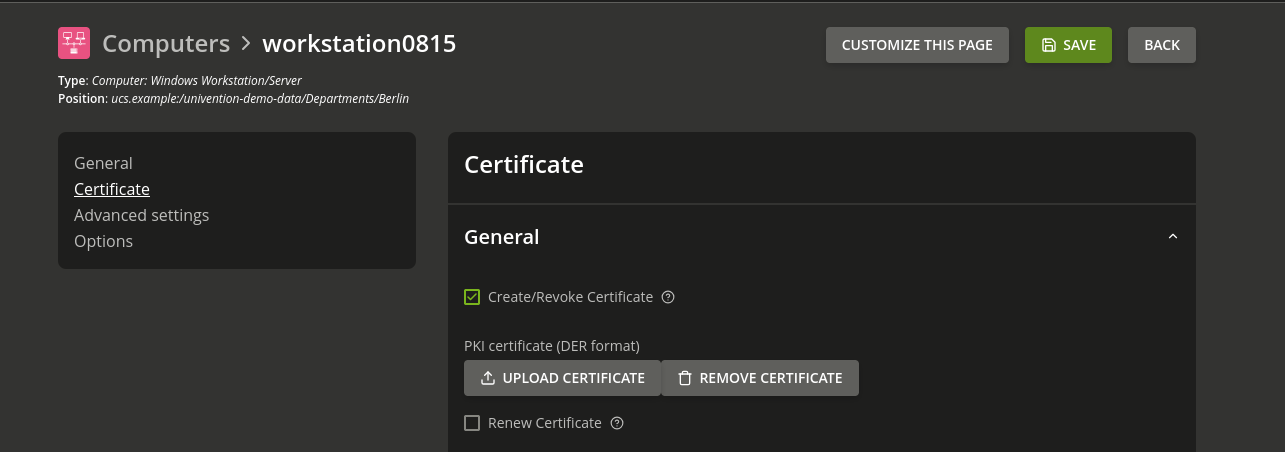

Now switch to the Certificate tab and select “Create/Revoke Certificate” . When saving, the certificate is created and will be stored under /etc/univention/ssl/windows-hosts/.
When a certificate is to be revoked, it is sufficient to untick “Create/Revoke Certificate”. The certificate files are removed from the LDAP, but not deleted from the filesystem. If the UCS root CA was used to sign the computer’s certificate, an entry is made into the Certificate Revocation List specified by /etc/univention/ssl/ucsCA/crl/ .
When a certificate needs to be renewed, it is sufficient to tick “Renew Certificate” and save the changes made. The old certificate will then be revoked and a new one will be created with the settings from the former certificate.
