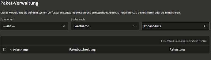

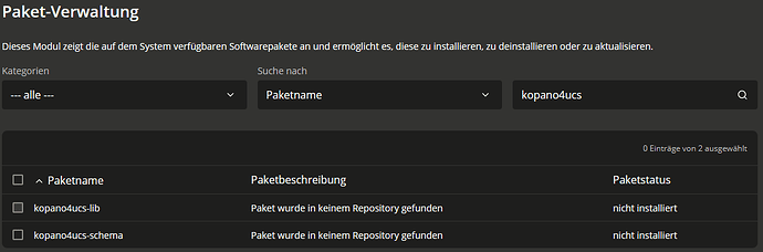

I still have no idea what paket or script I have to install to get that part fixed - so I tried to see if pakets related to “kopano4ucs” are installed on the PDC and BDC.
PDC (UCS 1):
(the search result found something - but pakets are not installed)
Via command:
grafik
(so was installed - just config has been left over)
BDC (UCS 2):
(nothing found)
Same for the cammand search - nothing found
Question 1: Do I have to "re-install the two kopano packets on the PDC again?
Question 2: Do I have to install the two kopano packets on the BDC - and if yes - how?
