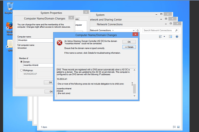

1. An Active Directory Domain Controller for the domain domainName.net could not be contacted.
In case a message similar to “An Active Directory Domain Controller for the domain domainName.net could not be contacted.” is shown,
Below are details of the above message:
The following error occurred when DNS was queried for the service location (SRV) resource record used to locate an Active Directory Domain Controller (AD DC) for domain “nosamba.intranet”:
The error was: “DNS name does not exist.”
(error code 0x0000232B RCODE_NAME_ERROR)
The query was for the SRV record for _ldap._tcp.dc._msdcs.nosamba.intranet
Common causes of this error include the following:
The DNS SRV records required to locate a AD DC for the domain are not registered in DNS. These records are registered with a DNS server automatically when a AD DC is added to a domain. They are updated by the AD DC at set intervals. This computer is configured to use DNS servers with the following IP addresses:
10.200.6.41
One or more of the following zones do not include delegation to its child zone:
nosamba.intranet
intranet
(the root zone)
