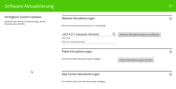

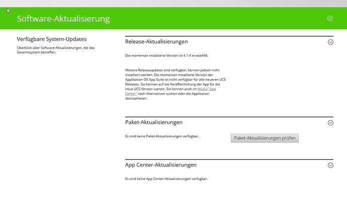

ok, the ox-update had no issues, but afterwards same problem on the master:
Checking for release updates: 2017-08-10 15:07:00,131 ERROR:updater.Updater:Missing component oxseforucs_20160421

So the I think this component is not needed anymore on the master and you can delete it. But this should be confirmed first by Univention.
This means, that you have installed oxseforucs_20160421 (7.8.1-7-ucs1) which is not available for UCS 4.2. But you said that OX was updated, so you should have a newer version. That is strange :wink:

looks like some orphan package, oesn’t it?
best
Sascha
Have you tried in the past to setup OX (install and uninstall) at the master?
But since it is not installed at the moment (“univention-app info” does not show any OX component at the master), you could deactivate the repository by
ucr set repository/online/component/oxseforucs_20160421='false'
and proceed with your upgrade.
Ok will do and report!
Wasn’t sure if that repo is needed for something on the master…
thanks and have a great weekend
