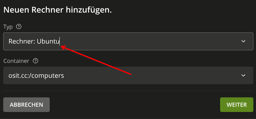

Have you ever tried creating the computer object first? And then performing the join afterwards?
No, I didn’t. Good Idea, I will try this tomorrow!
Thank you
Just tried this but without success.
The error message is the same as before.
