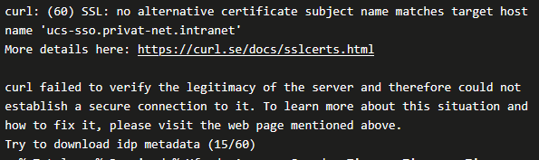

Hi - during the update on the primary system I noticed the following message:
I would assume this is an error message - but by using the system diagnostic all is in GREEN.
Anyone any idea?
Thank you in advance

Hi - within the update from 5.2-1 errata 62 to errata 118 I noticed the first time the below message in the update log.
Since that time, I’m checking the update log very carefully - and the message pops up every time.
I updated today to the latest version 5.3.x and it is still there.
Every time you check the system diagnostic, no errors are visible.
Can anyone explain what is going on here?
A simple guide to get this fixed - it there is the need to get it fixed - would be very helpful.
PS: I’m aware that also other (like passt) are facing this issue - but haven’t seen any solution yet.
