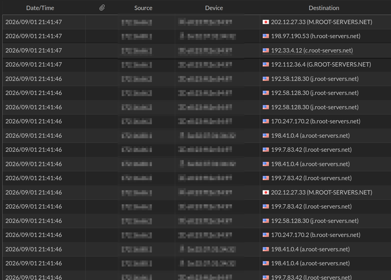

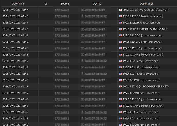

I‘ve maintained my firewall with some more restriktive rules and found out, that the UCS is permanently calling the Root-DNS Server with UDP Calls on Port 53.
Is there any reason for this?

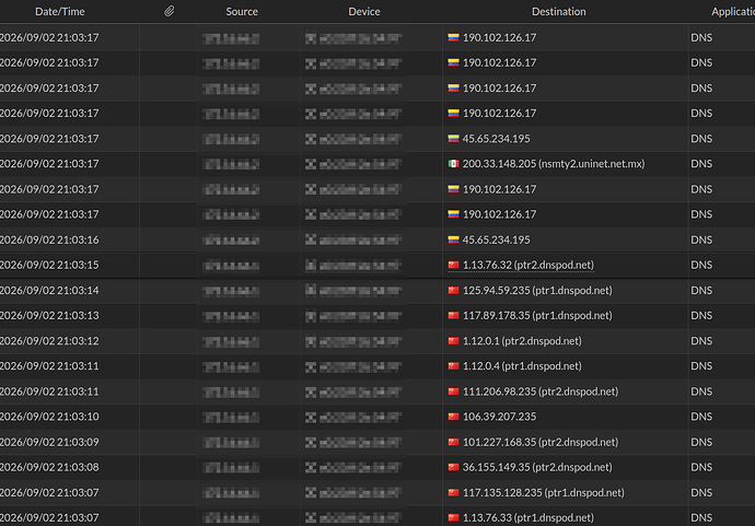

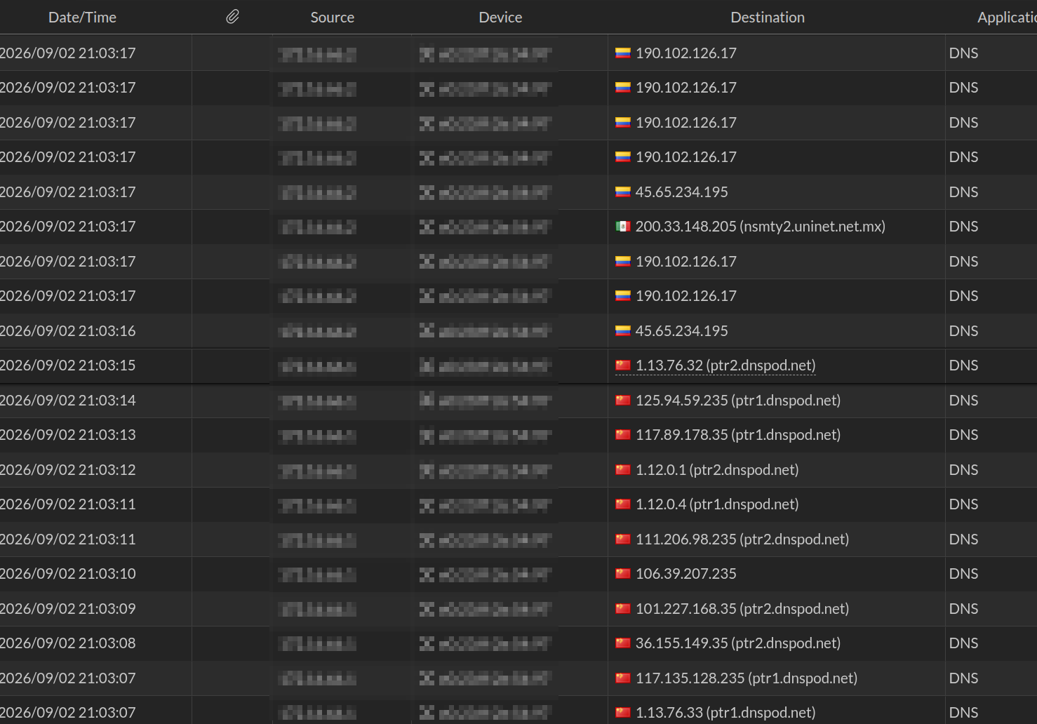

It also lists countries that I wouldn’t want to visit, such as China or Colombia.
