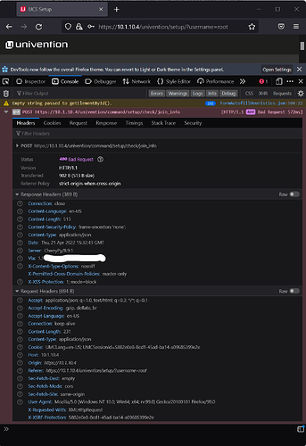

On another attempt I checked the Google Chrome console and saw that there were several errors with status 408 (Request Timeout) and one of status 400 (Bad Request).
I also attempted to access the server and complete the setup using Mozilla Firefox (99.0.1 (64-bit)) to see if there was a problem with Chromium based browsers but I experienced the exact same issue as on Google Chrome.- Here is the output of the console during this attempt (The obfuscated line represents the FQDN of the server, abc-nas1.ad.org.com).
