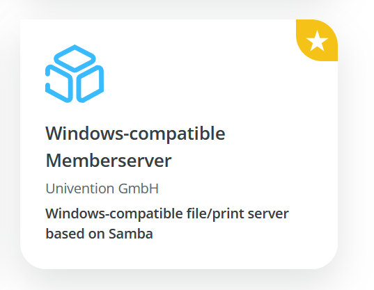

if you only want to have a member server then install this app on the backup ucs server´
