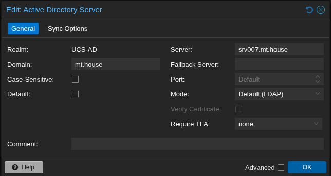

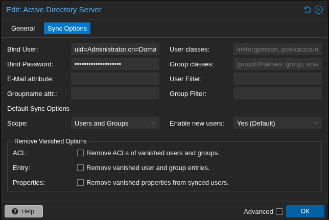

We have UCS providing our Active Directory domain, and we need to sync our AD users in PVE, but I cannot seem to get this to work (it worked fine with AD on Windows Server 2012).
Bind User = uid=Administrator,cn=Domain Admins,dc=mt,dc=house

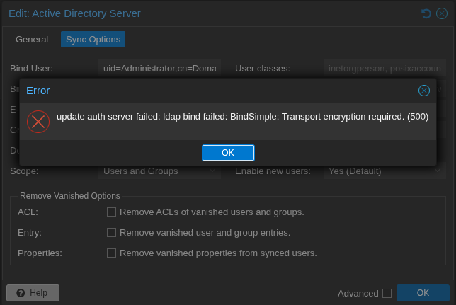

Hi @ucs_mt ,
Transport encryption is required, you don’t have it enabled within Proxmox when configuring the LDAP simple bind to UCS, hence the connection fails. Probably it was not enabled when using Windows Server 2012, thats why it worked there, but of cause it was not secure, as everyone could read passwords for all users in plain text when sniffing on the wire.
To solve this issue, you have to import the UCS root CA on all Proxmox servers, to allow them to trust the connection. When this is done, you need to enable transport encryption in the PVE config when configuring the simple bind.
Haiyaa… I noticed from the PVE screenshots that you are trying to use an administrative user with very high domain rights for the simple bind. Of cause, this would work, but be advised that this is a very high security risk.
My recommendation is to create within UCS a separate srv_proxmox (ServiceAccount, aka. “Simple authentication account”) and to use this account for the simple bind between PVE and UCS. But NOT the Administrator

Thank you for your reply. It set us on the right path and we were able to get it working.
