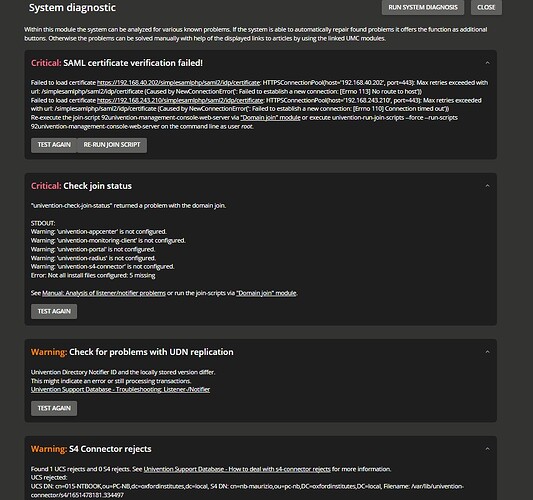

After the upgrade to the 5.0-2 i have the same problem with slam certificate and join status
i have try to follow this procedure but the problem persist …
then i tried to update to the latest version 5.0-3 it didn’t help
thanks in advance

the UCS is unusable, i can create a user but i can’t join the pc to the domain, i can’t connect a new backup UCS for migrate all the data to a new server … I am desperate
the univention-check-join-status report this
Warning: 'univention-appcenter' is not configured.
Warning: 'univention-monitoring-client' is not configured.
Warning: 'univention-portal' is not configured.
Warning: 'univention-radius' is not configured.
Warning: 'univention-s4-connector' is not configured.
Error: Not all install files configured: 5 missing
if i try run the commend univention-run-join-scripts the join.log file report this

ERROR: Primary Directory Node did not mark the extension object active within 180 seconds.
ERROR
ucs_registerLDAPExtension: registraton of /usr/lib/python3/dist-packages/univention/admin/syntax.d/s4_connector.py failed.
EXITCODE=1
533a6659-dd19-4378-8206-ad27a398ac7e
RUNNING 98univention-pkgdb-tools.inst
EXITCODE=already_executed
RUNNING 98univention-samba4-dns.inst
RUNNING 98univention-samba4-saml-kerberos.inst
univention-join-hooks: looking for hook type "join/post-joinscripts" on cloud.mydomain.local
Found hooks:
i did some other check … it seems that the univention-directory-listener service is not working can this be the problem of all ?
i have change the log level and restart the listener ( ucr set listener/debug/level=4 ) the log is on loop alway on this error
08.05.23 16:58:21.332 LISTENER ( WARN ) : Notifier/LDAP server is cloud.mydomain.local:7389
08.05.23 16:58:21.332 LDAP ( PROCESS ) : connecting to ldap://cloud.mydomain.local:7389
08.05.23 16:58:21.337 LDAP ( INFO ) : simple_bind as cn=admin,dc=oxfordinstitutes,dc=local
08.05.23 16:58:21.342 LISTENER ( INFO ) : connecting to notifier cloud.mydomain.local:6669
08.05.23 16:58:21.342 LISTENER ( INFO ) : established connection to 192.168.40.205 port 6669
08.05.23 16:58:21.342 LISTENER ( ALL ) : >>>Version: 3
Capabilities:
08.05.23 16:58:21.343 LISTENER ( ALL ) : RESULT: [(null)]
08.05.23 16:58:21.343 LISTENER ( ALL ) : <<<Version: 3
Capabilities:
08.05.23 16:58:21.343 LISTENER ( INFO ) : connection okay to host cloud.mydomain.local:7389
08.05.23 16:58:21.343 LISTENER ( ALL ) : blocking signals (was 0)
08.05.23 16:58:21.343 LISTENER ( INFO ) : cache_init: using default mapsize: 4295000000
08.05.23 16:58:21.343 LISTENER ( ALL ) : cache_init: Transaction begin
mdb.c:2433: Assertion 'mp->mp_pgno != pgno' failed in mdb_page_touch()
08.05.23 16:58:21.344 LISTENER ( WARN ) : received signal 6
the commad systemctl status univention-directory-listener returns
● univention-directory-listener.service - Univention Directory Listener Daemon
Loaded: loaded (/lib/systemd/system/univention-directory-listener.service; enabled; vendor preset: enabled)
Drop-In: /etc/systemd/system/univention-directory-listener.service.d
└─20_start_order.conf
Active: activating (auto-restart) (Result: signal) since Mon 2023-05-08 17:02:16 CEST; 3s ago
Docs: man:univention-directory-listener(1)
Process: 10926 ExecStartPre=/usr/share/univention-directory-listener/fix_cache_permissions.sh (code=exited, status=0/SUCCESS)
Process: 10929 ExecStart=/usr/sbin/univention-directory-listener -F $UDL_OPTS (code=killed, signal=ABRT)
Main PID: 10929 (code=killed, signal=ABRT)
