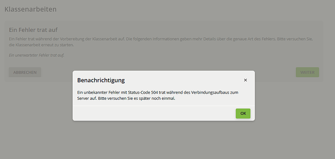

Problem:UCS@school - Exam mode Status-Code 504
When creating an exam, you get a status code 504 error in the UMC and it’s not possible to create the exam successfully.
