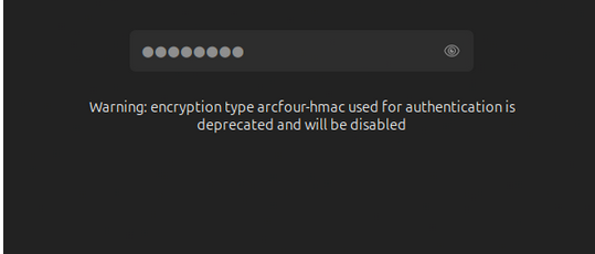

When users attempt to log in to Ubuntu (24.04) clients joined to a UCS domain, they receive the following warning:
Warning: encryption type arcfour-hmac used for authentications is deprecated and will be disabled.
Background
The warning "Warning: encryption type arcfour-hmac used for authentication is deprecated and will be disabled" indicates that the arcfour-hmac-md5 (RC4) encryption type configured in krb5.conf is outdated. Newer distributions like Ubuntu 24.04, which use MIT Kerberos, display this warning because RC4 is considered cryptographically insecure and will eventually be removed.

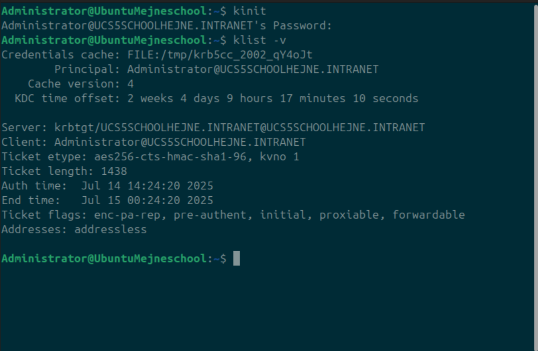

Step 5: Test Authentication and Verify Kerberos Tickets
After performing all the above steps, test the login on the Ubuntu client.
  1. Initiate a Kerberos ticket:
    On the Ubuntu client, open a terminal and run:
    kinit
    Enter the password for the test user you reset.
  2. Verify Kerberos tickets:
    Check the details of the acquired Kerberos tickets with:
    klist -v
    The output should no longer show on Ticket etype arcfour-hmac entrie and the authentication should be successful without the deprecation warning.
