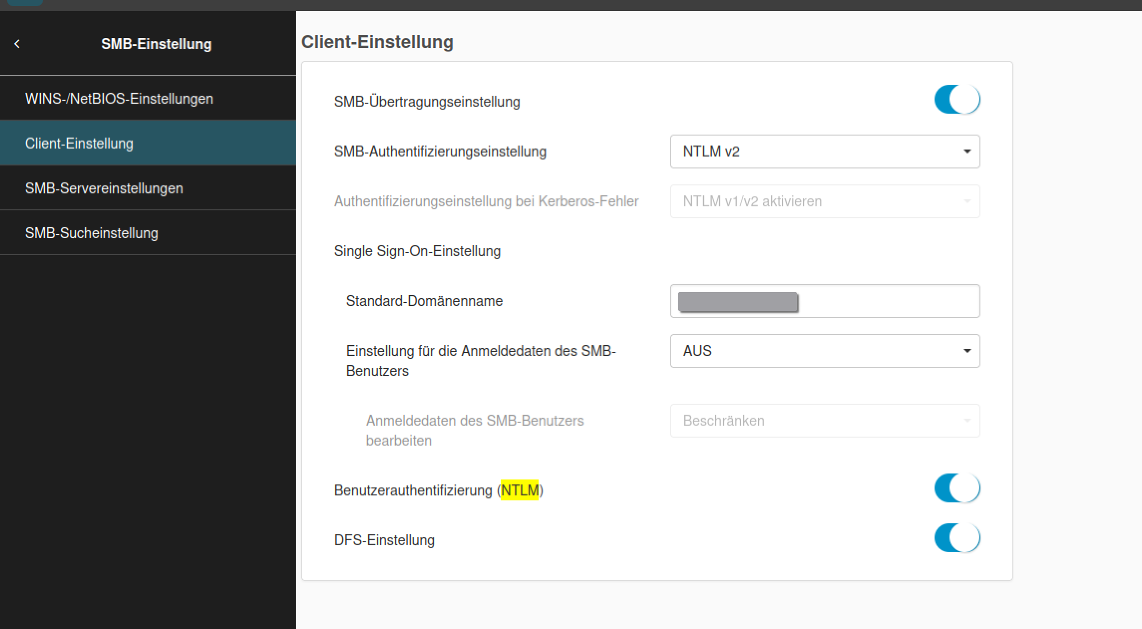

On the Develop ineo 250i scanner, configure the Default Domain Name field in the SMB scan settings:
This ensures the member server receives the domain name during authentication, allowing the user account to access the SMB share. After this configuration, SMB scans against the member server were successful.
