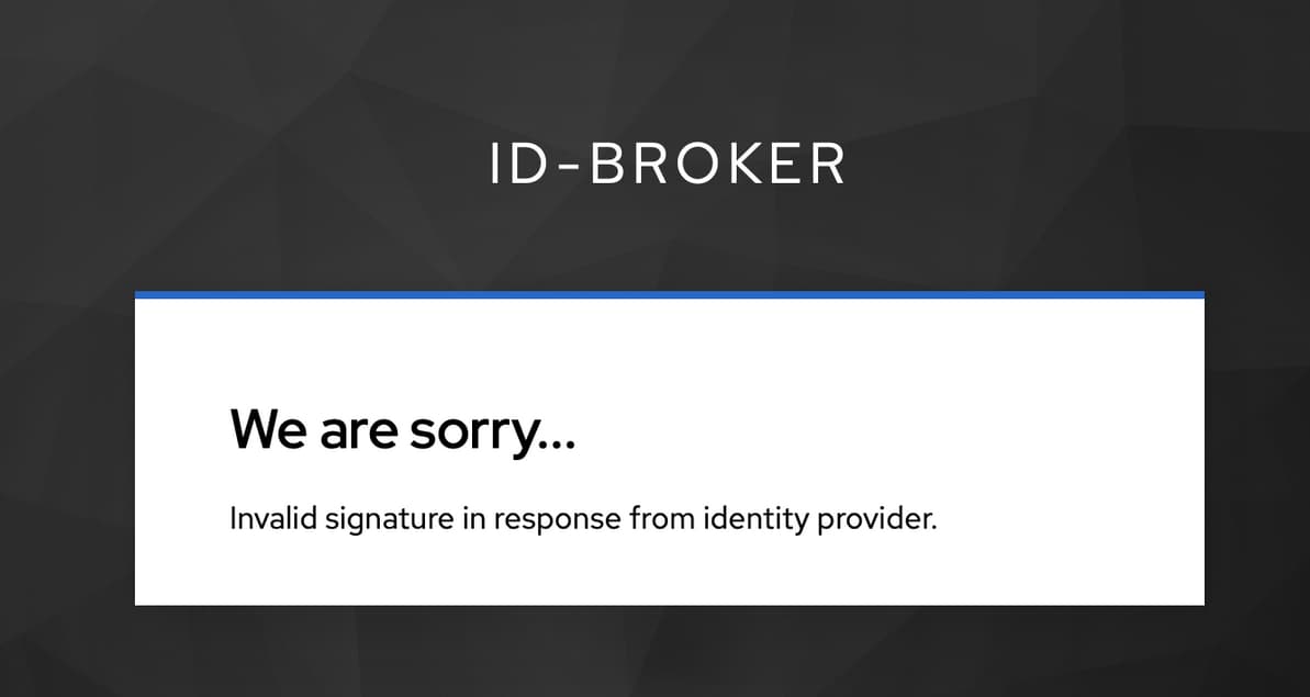

Problem: SSO Login Fails with "Invalid signature in response from identity provider"
Users are unable to log in to services through Single Sign-On (SSO) and receive the following error message:
“We are sorry… Invalid signature in response from identity provider”
The issue occurs when users start the login process through an itslearning tile in the Univention Management Console (UMC). Authentication is redirected via SSO to the ID Broker, where the login process fails with the signature validation error.
The problem affects all users and all client devices.
