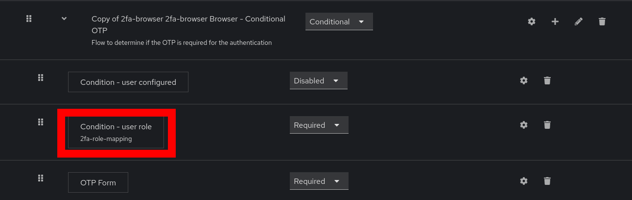

Manual Cleanup in Keycloak UI:
Log into the Keycloak Admin Console for the affected realm (typically
opendesk
Navigate to Authentication → Flows.
Delete the conditional flow associated with
2fa-role-mapping
Go to Authentication → Executions and remove any remaining 2FA-related executions.
