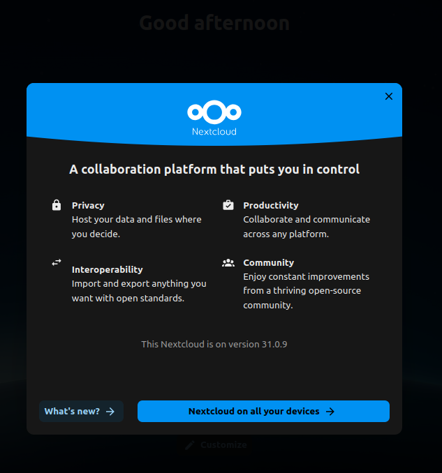

Step 7: Verify Successful Login
Log in to Nextcloud through UCS Single Sign-On (simpleSAMLphp).
The login should now succeed without 500 Internal Server Error.
