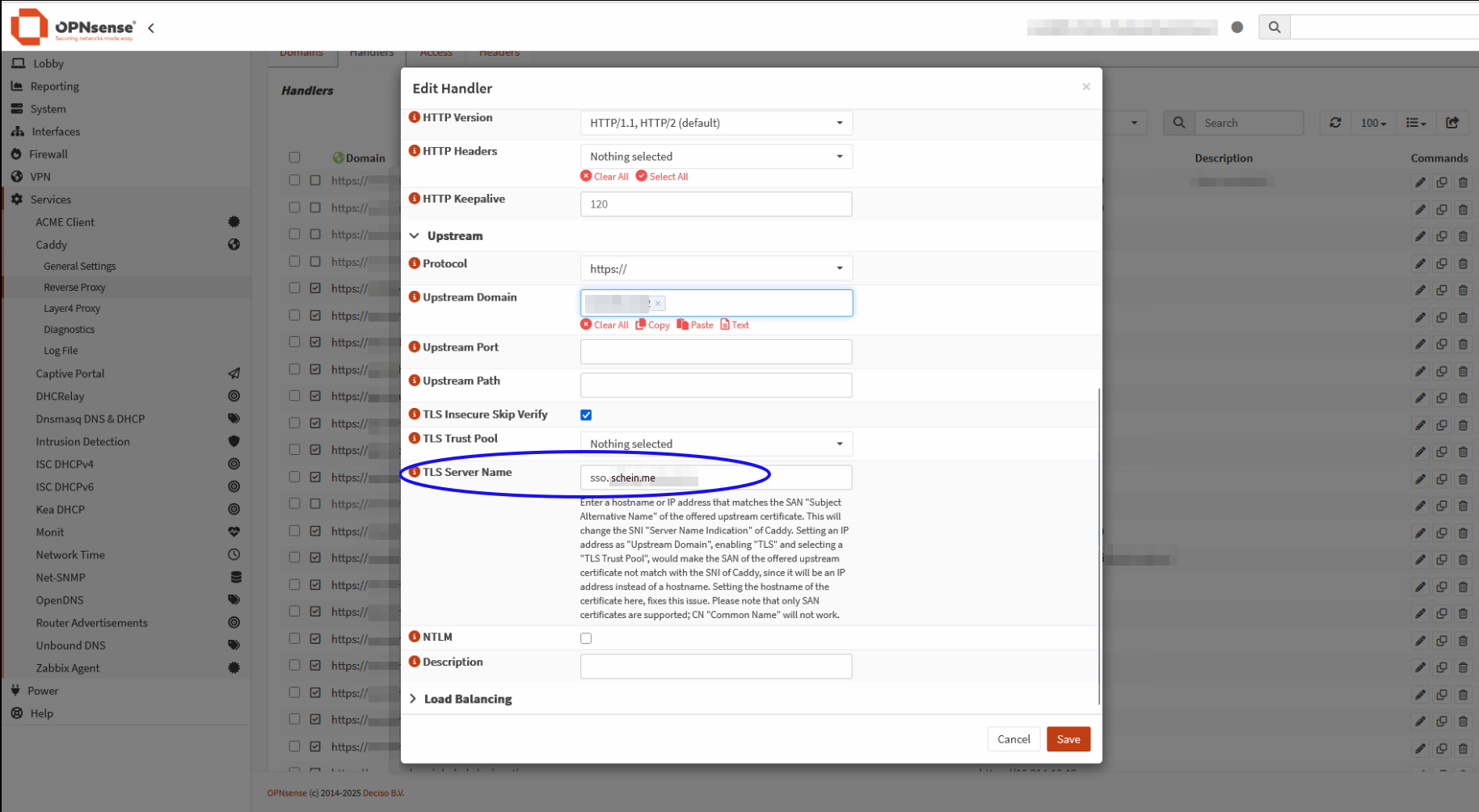

Option 2: Passing SNI Through to Backends
If TLS termination should remain on the UCS servers, configure HAProxy to forward SNI correctly to each backend.

Konfiguration example in opensense:
