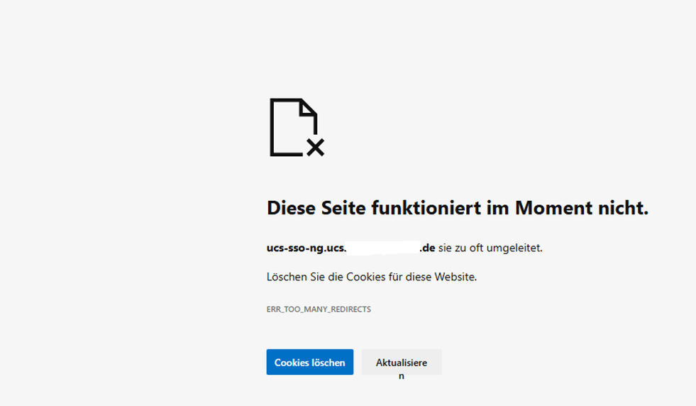

The Keycloak administration console is not accessible from enxternal network when accessed through HAProxy, the browser returns ERR_TOO_MANY_REDIRECTS, preventing access to the application.
The issue can be reproduced using curl, which reveals an endless sequence of HTTP 301 redirects. Instead, the behavior indicates a reverse proxy configuration issue, most likely related to the communication between HAProxy and the backend service.
When accessed externally, the browser displayed:
