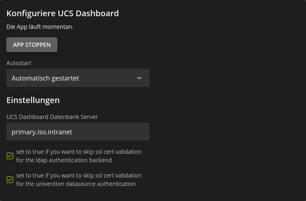

Problem: Grafana dashboard doesn't trust the CA certificate
The Grafana Dashboard does not trust the CA certificate of the UCS server on which the Dashboard is running.
If you’re using a wildcard certificate or a certificate that is not issued for the machine, the certificate check must be deactivated. However, this is where it gets a little tricky, because this has to be done on the dashboard itself as well as in the database.
So once in the app settings of ‘UCS Dashboard’:

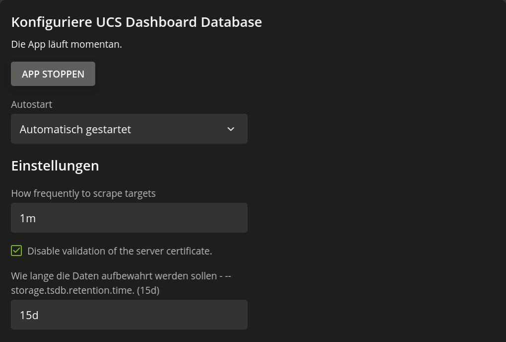

and in the app settings of ‘UCS Dashboard Database’:
