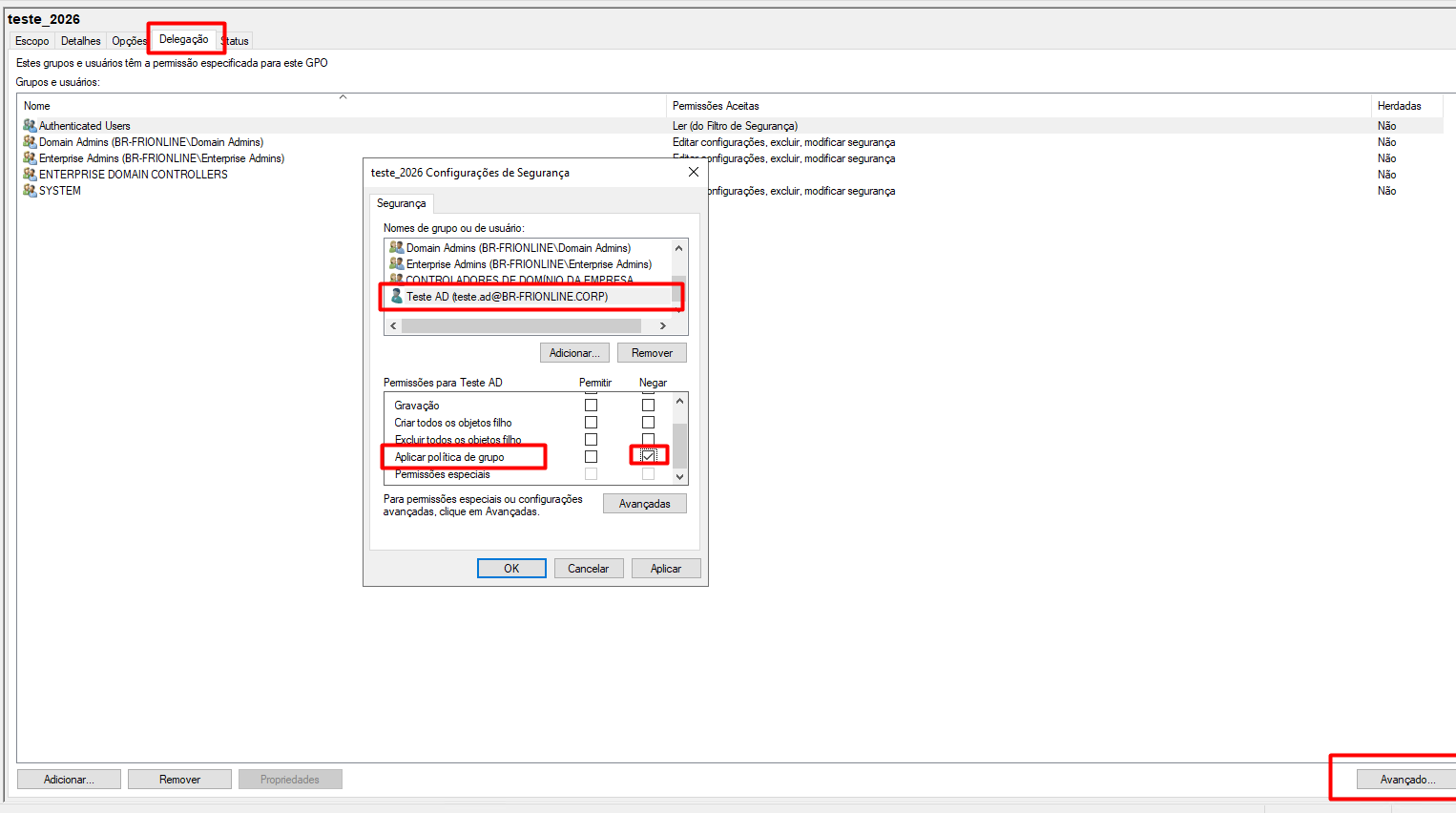

Problem: GPMC/MMC is crashing when delegation is used to deny policy for user/group

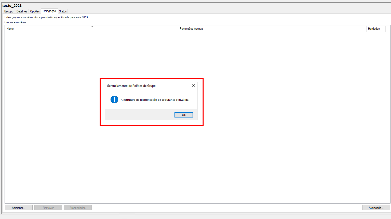

Every time I try to delegate a new or existing GPO to deny a user/group access, the GPO shows errors such as:
The security identification structure is invalid.

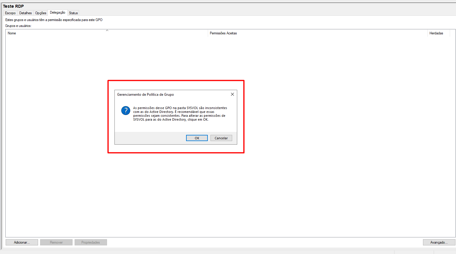

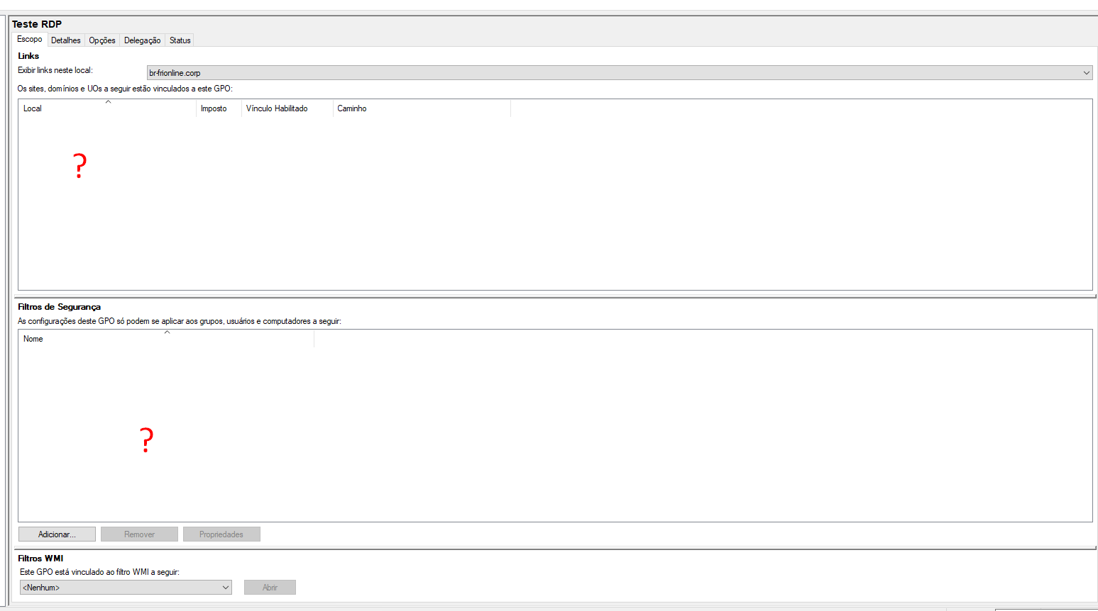

The Enterprise Domain Controllers group does not have read rights for this GPO. The Enterprise Domain Controllers group needs to have read rights on all GPOs in the domain for Group Policy Modeling to function correctly.
After that, I can’t use the GPO unless I delete and recreate it, but without trying to delegate permissions to deny permissions to a user or group.
