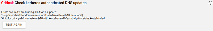

Problem: Check kerberos authenticated DNS updates
In the System Diagnosis you see a critical warning saying
Environment
First check the situation a bit further.
