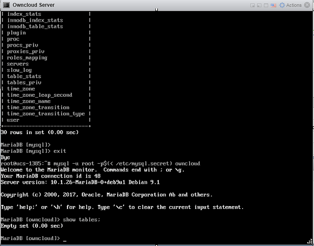

when I start the docker container of owncloud I now get the following ouput:

Upgrading server database...
An unhandled exception has been thrown:
PDOException: SQLSTATE[42S02]: Base table or view not found: 1146 Table 'owncloud.oc_appconfig' doesn't exist in /var/www/owncloud/lib/composer/doctrine/dbal/lib/Doctrine/DBAL/Driver/PDOConnection.php:104

Next Doctrine\DBAL\Exception\TableNotFoundException: An exception occurred while executing 'SELECT * FROM `oc_appconfig`':
SQLSTATE[42S02]: Base table or view not found: 1146 Table 'owncloud.oc_appconfig' doesn't exist in /var/www/owncloud/lib/composer/doctrine/dbal/lib/Doctrine/DBAL/Driver/AbstractMySQLDriver.php:53

Alright, let’s take a look at the DB’s content. First, start the MySQL client again, then post the result of the second line (to be run inside the MySQL client):
# In the shell:
mysql -u root -p$(< /etc/mysql.secret) owncloud
# In the mysql client:
show tables;
Here the result of
0001
Mark
You connected to the mysql database instead of the owncloud database. Therefore your screenshot shows the tables in the database named mysql.
Either run the mysql command like I said above (mysql -u root -p$(< /etc/mysql.secret) owncloud), or once you’re in the MySQL shell connect to owncloud with the command use owncloud; before running show tables;.
You are right. Did make a type mistake.
Owncloud table is empty. It only shows:
Empy set (0.00 sec)
That’s obviously not good, but at least we know what’s wrong. Looks like something went seriously wrong during the upgrade, leaving you without your data.
You’ll have to restore that database from backups. Hopefully a dump was created by the upgrade process in /var/lib/univention-appcenter/apps/owncloud/data/backup or /var/lib/univention-appcenter/apps/owncloud/data/backups (I have one in both directories for some reason).
