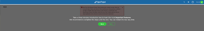

I have an error after update openproject, I have a message 422 after login that says: Unable to verify Cross-Site Request Forgery token. Did you try to submit data on multiple browsers or tabs? Please close all tabs and try again. The OpenProject cookie is missing. Please ensure that cookies are enabled, as this application will not properly function without.

did it look like this?

Ok - I still get the same error : Unable to verify Cross-Site Request Forgery token. Did you try to submit data on multiple browsers or tabs? Please close all tabs and try again. It wont let any account log in that was active before in v7.3
