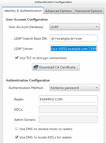

Then login via GUI (i did with Gnome) and start: Applications → Sundry → Authentication.
Configuration should lock like that:
On the 2nd tab (Advanced Options) i disabled “fingerprint reader support” and enabled “Create home directories on first login”.
Apply your Changes.
Logout and login with a domain-user.

It appears to have connected, but I do not see all of the domain usernames and password using getent passwd.
Also under authentication, I see you need to select TLS. Do I have to download a CA Certificate from the UCS?

I also did return to the GUI and ran the Authentication Configuration I did what you told me but this time I also edited the path after clicking the Download CA Certificate I tried using "http://192.168.2.129/ucs-root-ca.crt" the same one I used above. It seemed like it worked… at least it was a good path… but # getent passwd did not show any different results after running it again…
I tried to rerun the entire script again as you stated previously, it looks like it runs, but I still cannot log in with a domain user and # getent passwd does not show an updated list :frowning:
