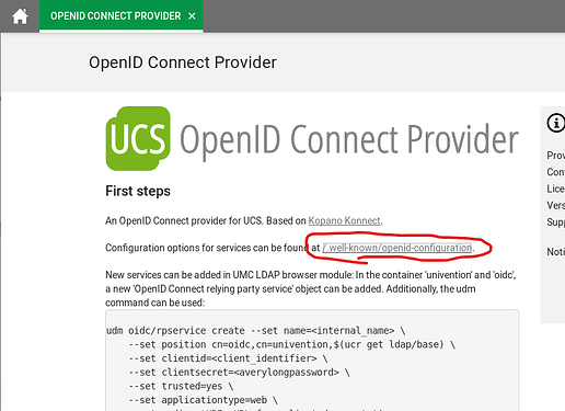

strange. this works out of the box with me. That its a 404 indicates that the webserver has maybe not restarted after the app has been installed (it should do so automatically, though). Only other reasons for the 404 is if you had used the wrong fqdn. Did you try to get to the discovery document from within the app?
This FQDN is the same url where we access the UCS server right, for example if I am able to access the portal here https://mysite.northeurope.cloudapp.azure.com/univention/portal/ and this https://mysite.northeurope.cloudapp.azure.com/ is my FQDN right? I am not sure how to get the discovery document from the app, can you please say me how? Thanks in advance.
I’ve circled it for you
But yes, the fqdn is the domainer you also use to access the ucs portal with. But actually the .well-known/openid-configuration
