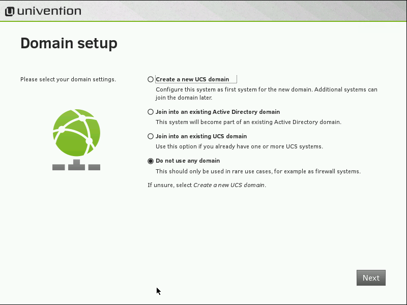

Here are the steps so far…
oops, took a screenshot on the wrong button… I didn’t choose no domain, just fyi
needed to set a static IP and dns here
Here is where I am not sure what option to choose
