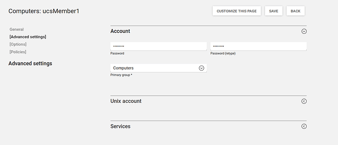

Good Afternoon andreaussi
this error message occurs when the machine’s password is changed i.e either the contents of the /etc/machine.secret file is changed, or a new password is entered in the UMC. The postgresql cannot identify the machine, as a result authentication failure.
The best way to solve this problem is to copy the current machine secret in the /etc/machine.secret file of your machine, and paste it in the UMC module Computers.
cat /etc/machine.secret
Select the computer in question, in your case, ucs-7758, under Advanced settings → Account paste/enter the copied password in the Password field, as shown below
  • Don’t forget to save
Regards
Anna Takang.
