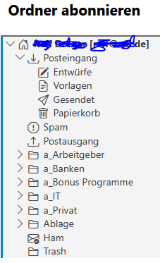

  • also not sure what trigger it is, but when sitching between folders, mainly my main mailbox (the top one) is showing no more mail in the inbox - and all additional folders are gone as well.
  • In some folders (e.g. DRAFT) I can still see mails.
  • Than it takes some time - and I can reload all folders
  • And than all folders are back - and all mails are back as well

Your link @StefanU is pointing me to version 23.1.20240416 - but I’m already on a higher version:
grafik
Also today I was facing the issues 2 or 3 time - but had not the time to troubleshoot. Now I have the time, but I’m unable to reproduce the issue ;-(
