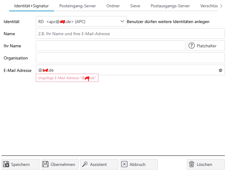

Hi - I’m accessing two account from my account. Both on the same egroupware server. I would like to call one as primary (directly linked with my account and the other the secondary (added later on).
Within the primary I can add and delete different identities. With the secondary I was able to add new once a longer time ago - but than I identified, that I’m unable to delete these identities. I’m getting the following error after selecting the one that I want to delete (just selected):
As you can see - there is as well no option to delete the identity - just the account itself - what I don’t want.
grafik
I can still use these identities when sending mails.
I’m on version:
grafik
I can still add identities - but deleting it right after is not possible.
Any idea who to solve this?

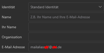

Anyway - I found myself a solution for it.
The issue was a missing config bit.
After adding the mail address that belongs to that mailbox - it was working and I was also able to add or delete identities.
Before:
grafik
So simple :wink:
That’s a validation error, the garbled email address caused the form not to be transmitted to the server.
