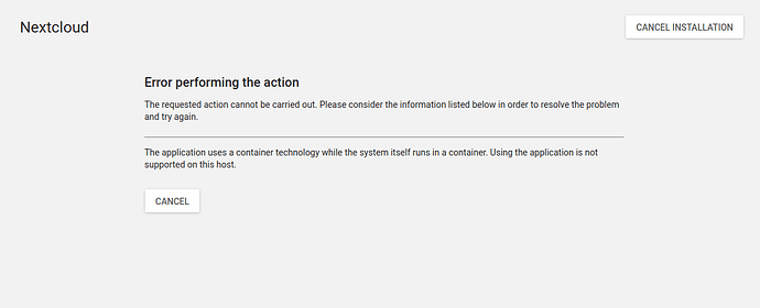

After the initial setup, I recognised in the AppCenter that I cannot install applications that are provided in the AppCenter itself as docker based applications. Problem: The univention/ucs-master-amd64 image does not provide a docker.io service itself. That makes sense! Because installing Docker images in Docker images makes little to no sense. But that brings me back to the question whether Docker is currently useful for UCS operation, at least in conjunction with AppCenter? According to current knowledge:
  • Either UCS in Docker should recognize that it runs in Docker (I think that’s already the case) and request privileged as container permissions so it can use the Docker host’s docker.io to deploy and manage containers itself.
  • Or the AppCenter provides an API to register containers from compatible images (as I see it, the images have to be built specifically for UCS anyway, for LDAP integration etc. to work) with the UCS.
  • Respectively, a combination of both variants would be possible.
In short, I have not found a case in documentation, wiki or forum while testing this scenario. Therefore I summarised the question to you:
