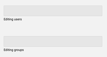

@Moritz_Bunkus I’m stucking on Go to the LDAP directory and edit the container via right click -> Edit and move to the tab authorization. Now you can add one or more users with their DNs
Both options are grayed out:
—> missed Editable after creation: (check this box)
Another not fully clear thing:
ucr set ldap/acls/temporary_objects/groups="<DN of the group of your user>"
Should that be the group, which should have rights to edit groups/create users or the group where the users, which will be created/edited, are in?
Thanks a lot
