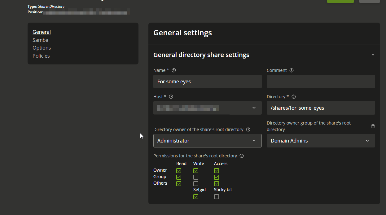

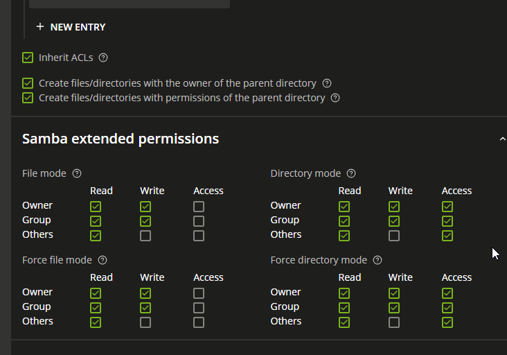

Is there antying else I should take into account? Below is my current sambashare.conf (location: /etc/samba/shares.conf.d)

(fyi: I configured this share through the webgui but I find it easier to share the conf than through several screenshots)
