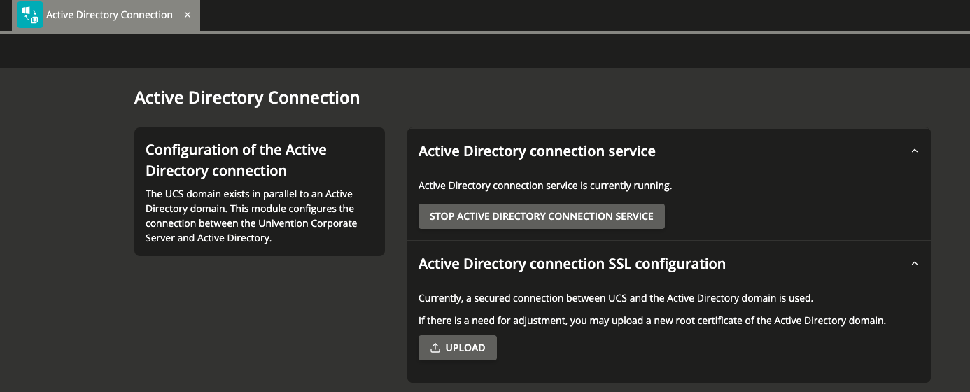

On the server where the “Active Directory Connection” is installed select In UMC the (turquoise) Domain modules.
If you open the Module you should see this:

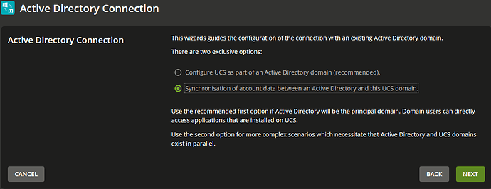

Thank you. However, I think this option only appears after a successful first setup. In my case, I am still at the first wizard stage, with the following screen :
I would like to choose the second option (Synchronisation of account data between an Active Directory and this UCS domain).

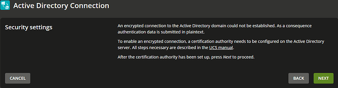

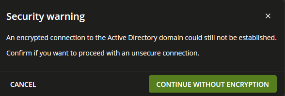

Then I get the Security settings error :
As requested, I created a certification authority on the Active Directory server.
After that, I would have to import it, as indicated in the aforementioned documentation.
But the Active Directory Connection module doesn’t have an Upload button yet at this point…
How and where to put this certificate ?

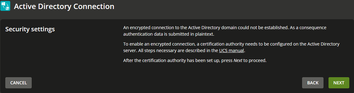

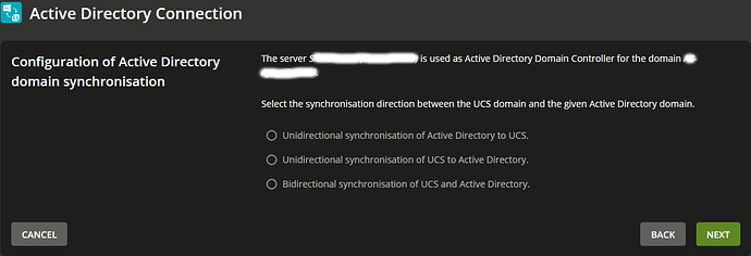

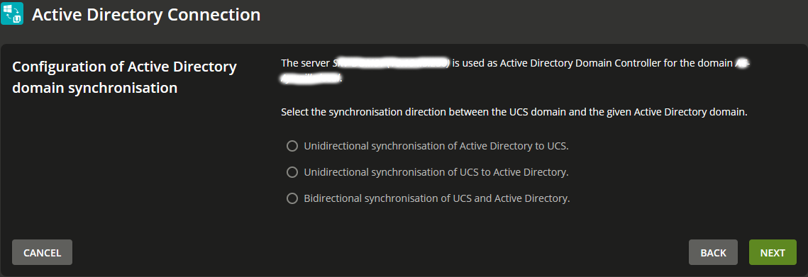

After clicking on next :

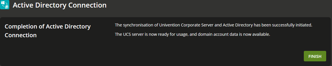

and then :

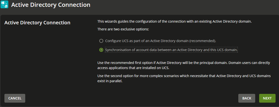

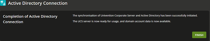

I chose bidirectional and then :
I didn’t have the ability to upload the certificate. I don’t know if I should worry about it.
