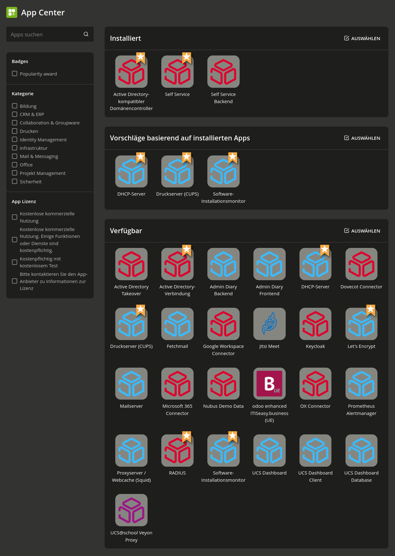

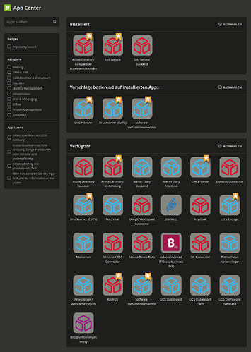

This is available at the moment in 5.2:
But as mentioned the selection is very limited.
What I`m missing is Nextcloud and Open-Xchange.
I installed a fresh server for a new customer and this limited choice was surprisingly for me.
Is there a chance to get this in the near future or should I setup additional VMs & container for that (Galera Cluster, OX Appsuite 8, NC)?
