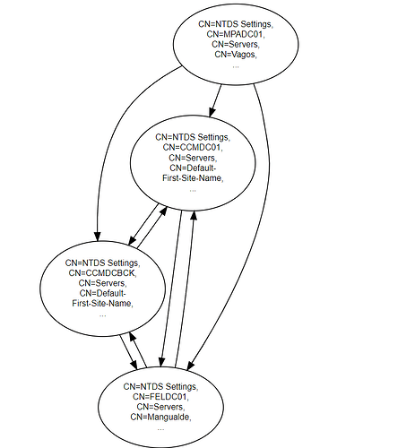

After more digging i use samba-tool uptodateness and get some UTD vector for dsa missing also samba-tool visualize
samba-tool visualize ntdsconn -S --dot -o network.dot
and get this image
As mentioned earlier samba-tool drs shworepl reports errors, however the slave dc appear to be syncs with the others, can’t underdant how to solve the issue that is missing “arrows” from all the servers to the new slave dc…
