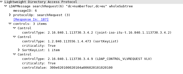

Sadly there are no logfiles for the AD Connector but using tcpdump and Wireshark we could see that the request looks like this:
the result is:

We compared the supportedControls attribute of a AD Simple AD and an UCS AD.
The UCS AD is missing 3 controls. One of them is marked as critical in the query:
controlType: 2.16.840.1.113730.3.4.9 (LDAP_CONTROL_VLVREQUEST VLV)
As I understand it this control is a LDAP overlay (sssvlv). I tried to activate it by adding the line
overlay sssvlv
to /etc/ldap/slapd.conf and restart the service. But it fails to start.
