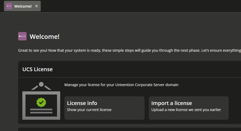

I know this is a basic question but did you activate your UCS (do you have a licence)?
Hi!
no, it’s the Core version. I didn’t know, that a licence is required for that
You have to activate your UCS, it’s free but still needs to be done.
Go to UCS home page, Welcome tab and you can activate there.
See if this helps
Ok now a licence is installed, but the error is still the same
